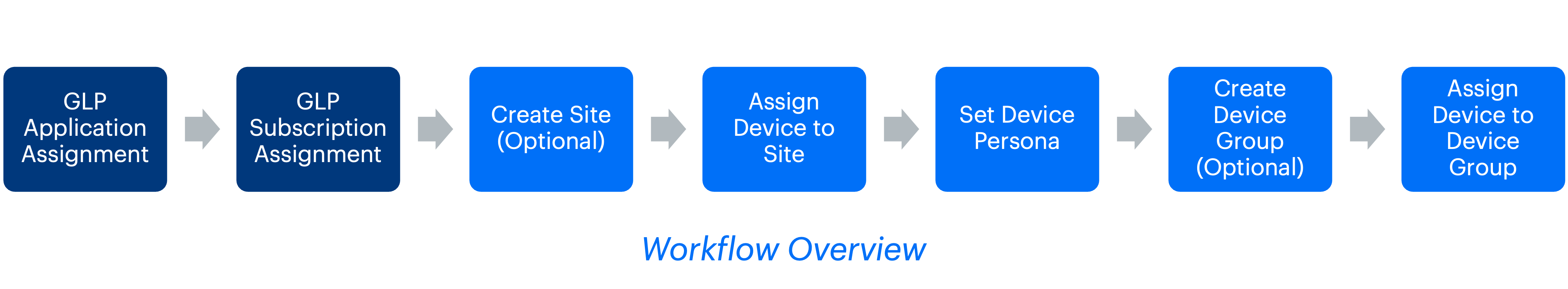

Once you have setup the configuration & input variables file, you can onboard your devices using the script. The script processes each device through these steps:
- Input Validation - Validates configuration file structure
- GLP Onboarding(Optional) - GLP Application and subscription assignment
- Central Onboarding
- Create Site (If site doesn't exist)
- Assign Device to Site
- Set Device Persona
- Create Device Group (If device group doesn't exist)
- Assign Device to Device Group
- Verification - Confirms provisioning status
