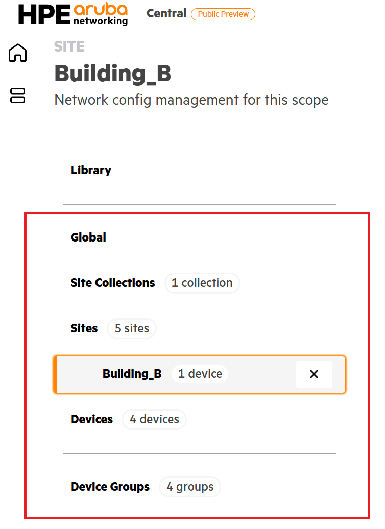

From the configuration screen select a valid scope from the sidebar. In this example we have selected the site 'Building_B'.

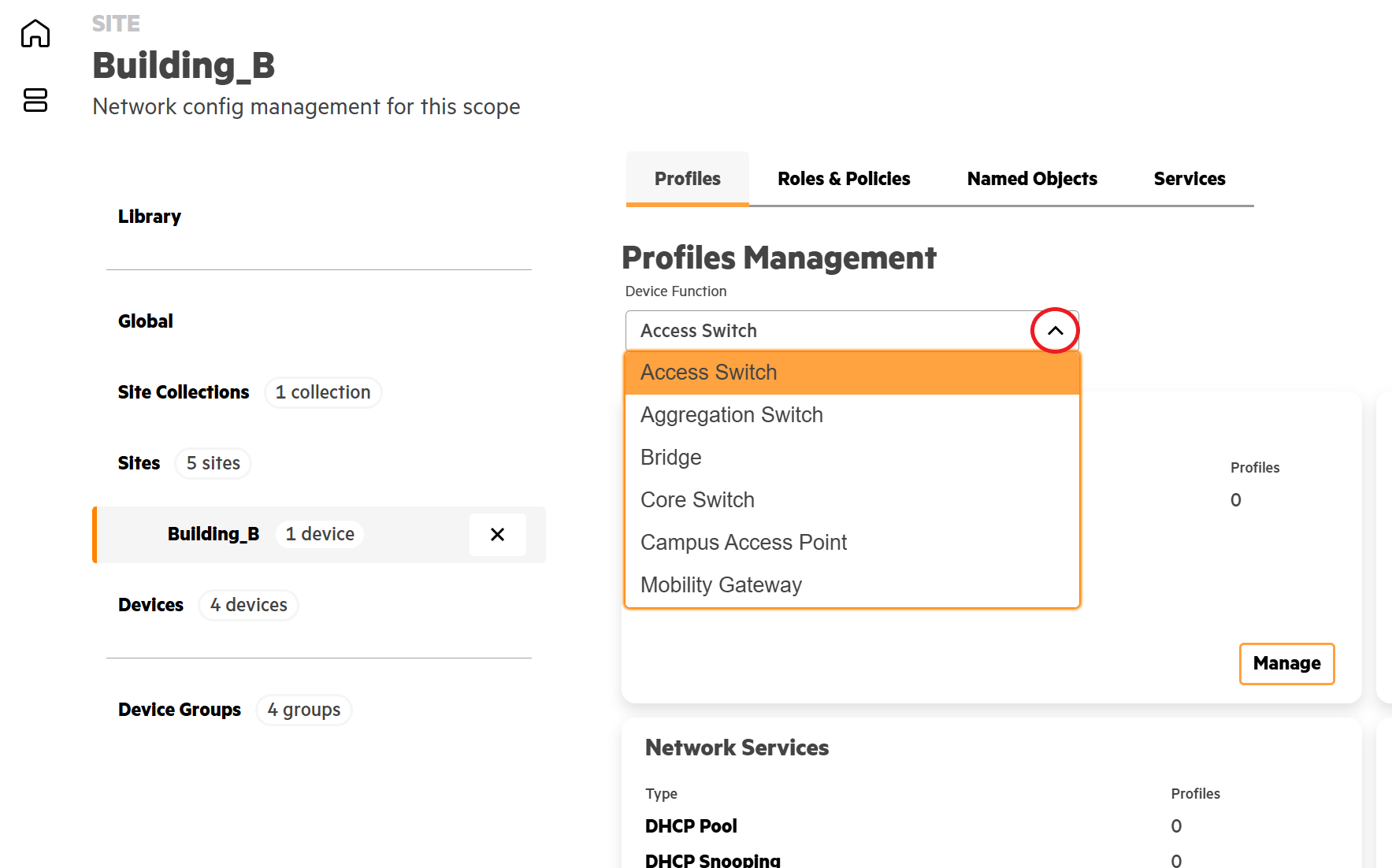

Expand the Device Function drop down and select a function

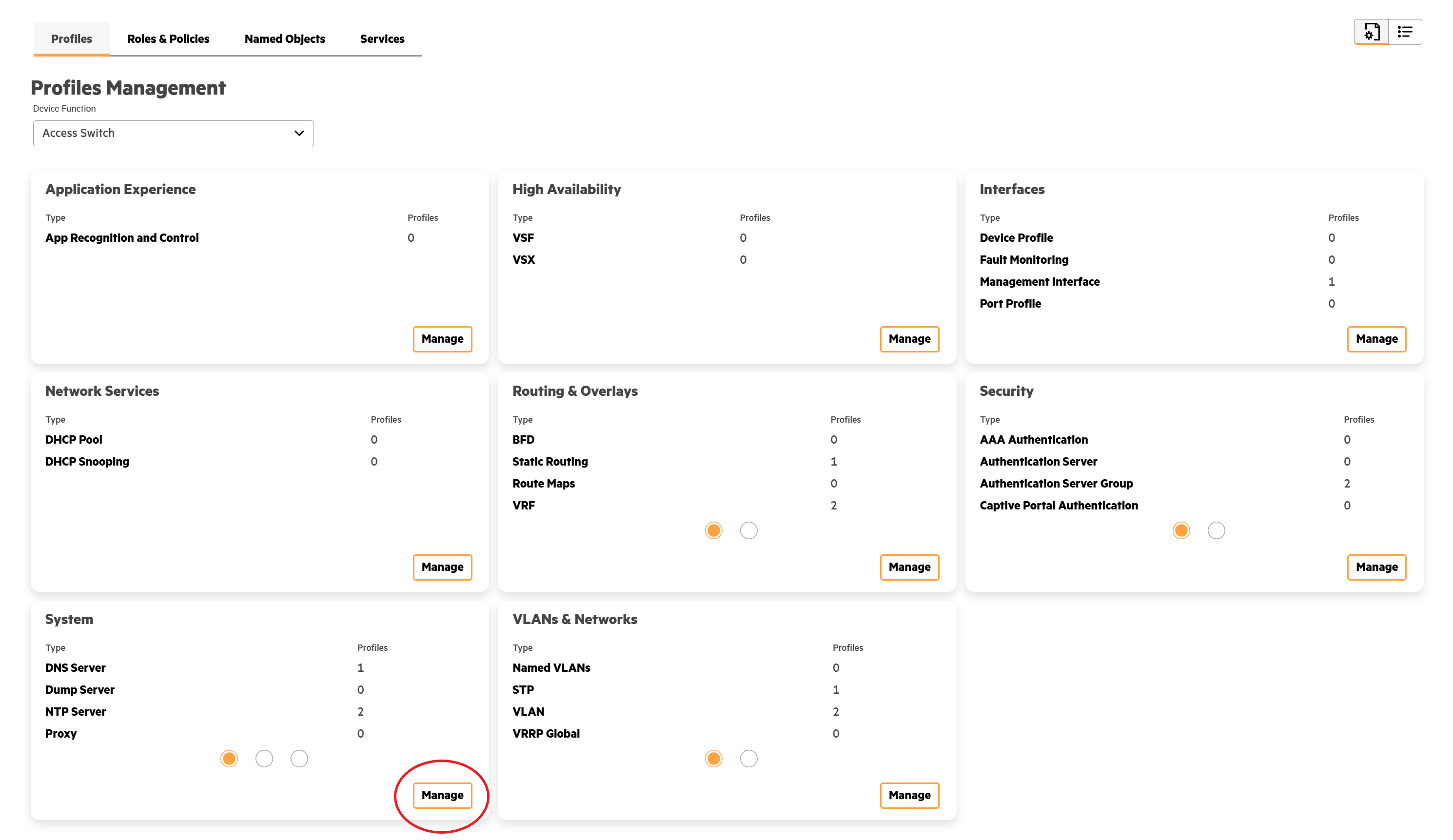

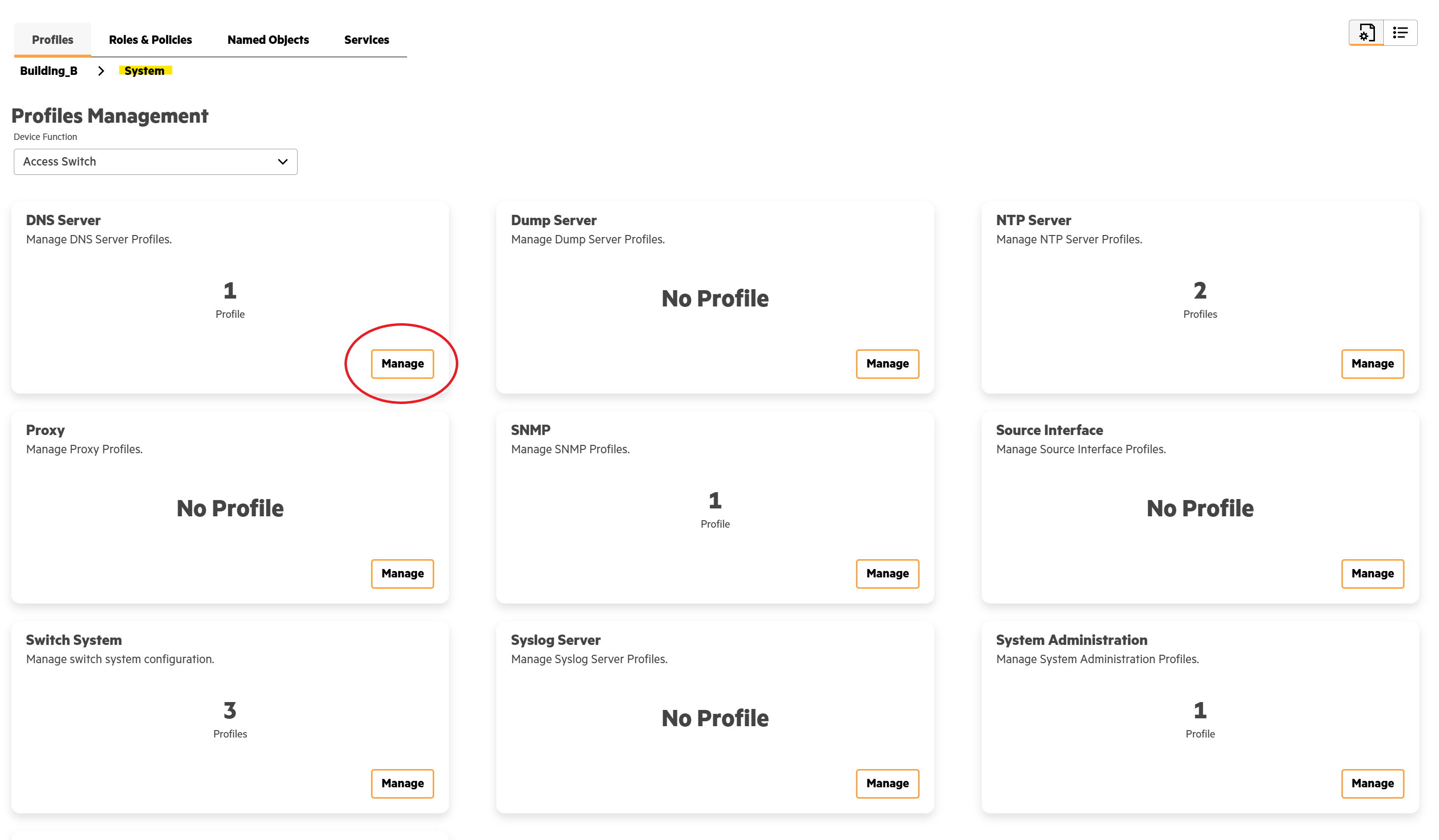

Select a profile management category card applicable to the profile type you want to create
Select a profile card for the profile you want to create

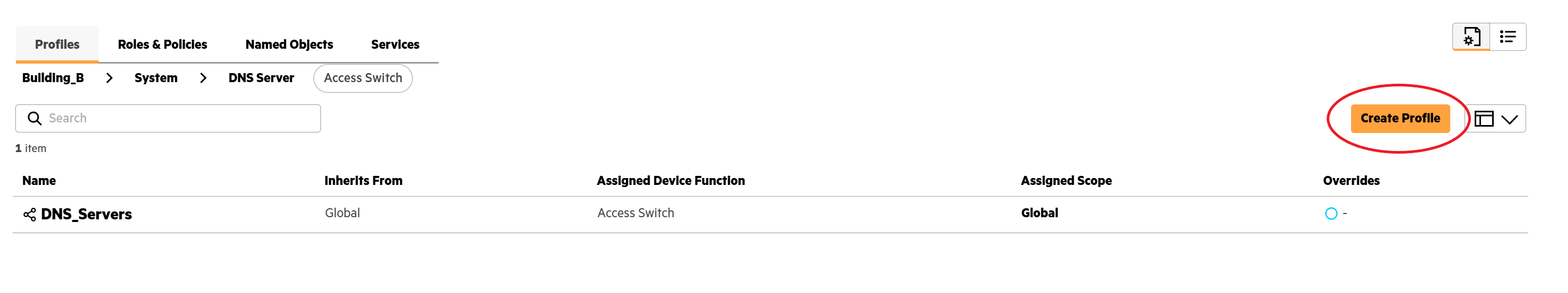

Select the 'Create Profile' button to open the create profile workflow

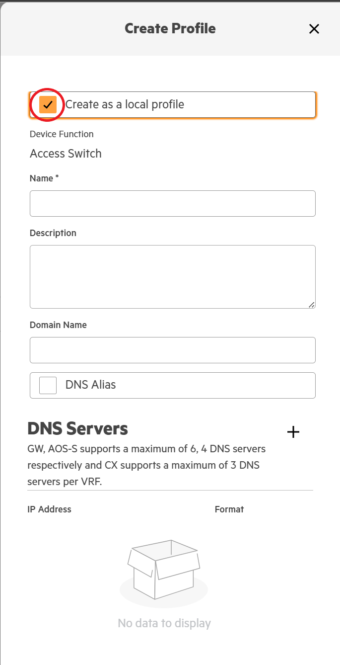

Check the 'Create as a local profile' box and continue creating your profile as normal. Completing the profile creation with this option checked will create a local profile specific to the selected scope from step 1.

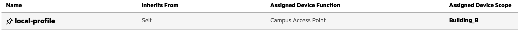

A local profile will have a thumbtack icon to the left of the profile name and be denoted as inherits from 'self'. It will also specify the scope it was created under 'Assigned Device Scope'.

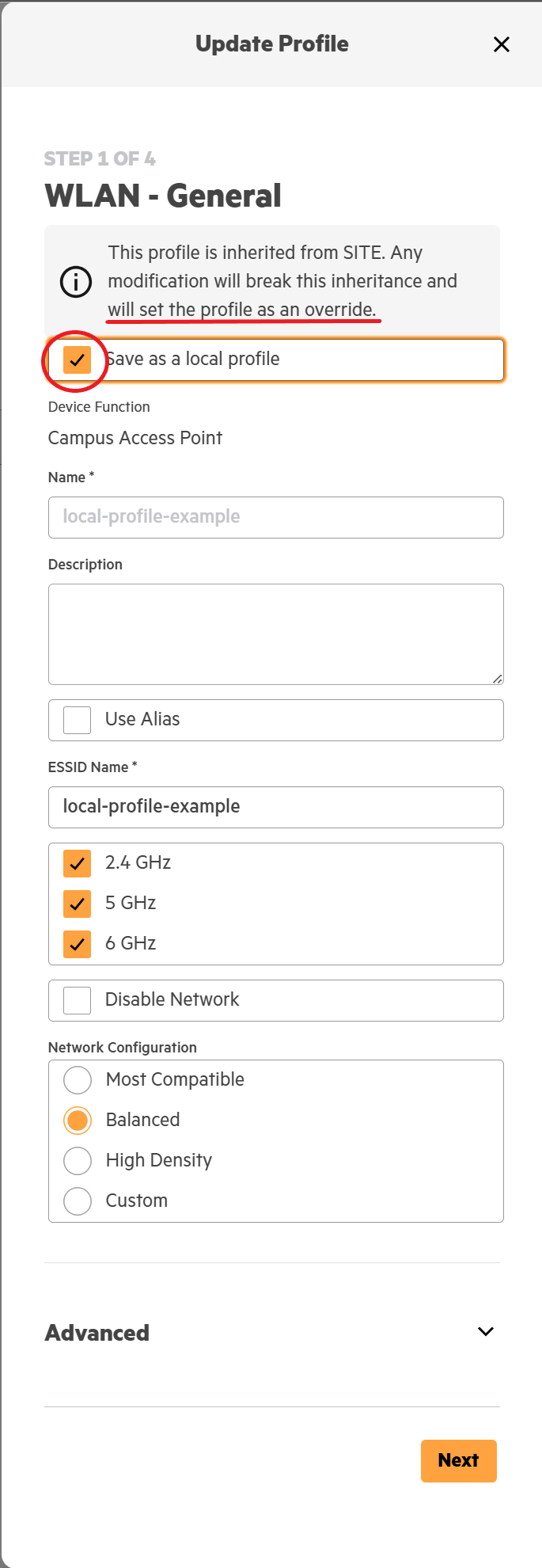

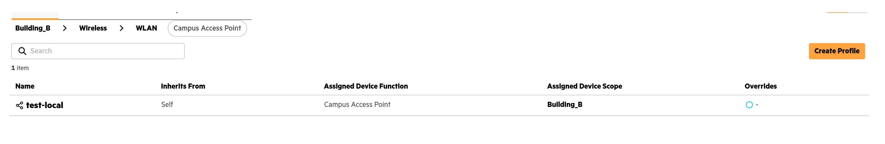

Select an existing assigned/inherited profile to edit. In this example the 'test-local' profile has been assigned to the site scope 'Building_B' from the library.
In the profile update workflow check the box 'Save as a local profile'. Then continue updating the profile as normal. Once complete, the previous profile will be overridden and replaced as a local profile.
Local Overrides and InheritanceAn overridden profile will apply the local profile configuration not only to the scope of the local profile, but also to all scopes that inherit from the scope of the new local profile. From our example, all campus access devices in the site Building_B would inherit this profile.

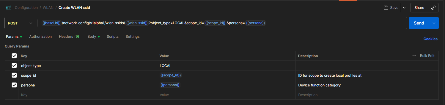

To create local profiles using the REST API we will create a POST request using configuration endpoints. We will need to add special parameters to the request to make the profile local in addition to the usual requirements. The parameters you will need are 'object_type', 'scope_id', and 'persona'. For more information about working with the Central API please visit our Getting Started with REST APIs guide. You can get started quickly with APIs using our Postman Collection guide.
The 'object_type' parameter is always 'LOCAL'. To get the scope ID for where we want to create the local profile please reference our Scope ID guide for full details on this process. The persona is equivalent to the device function from the Central UI. Here is a table with device functions and their persona equivalent:

With the above information gathered we can add them to our request parameters. Here is an example using postman with the request parameters populated and applied.
In addition to adding the local parameters, you will also need to fill out the body of the request as you normally would to create a profile. Then, run the request and you will have a newly created local profile!
Missing/Incorrect ParametersPay careful attention to the result of your request. If the 'object_type' parameter is missing in the API request, the profile will default to being created and stored at the Library Level. Incorrect parameters will result in a 400 bad request error.

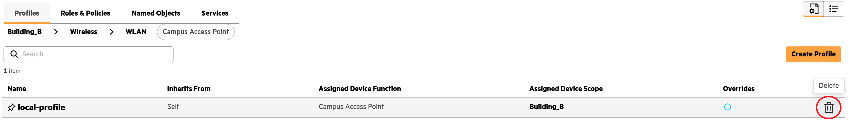

Navigate to a profile management card in the scope, find the trash can icon at the end of the row and click it.

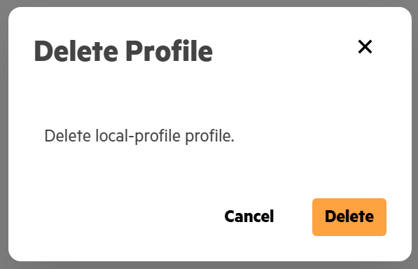

Clicking the icon will generate a popup with a delete confirmation. Confirm the delete by pressing the delete button. The local profile will now be deleted.

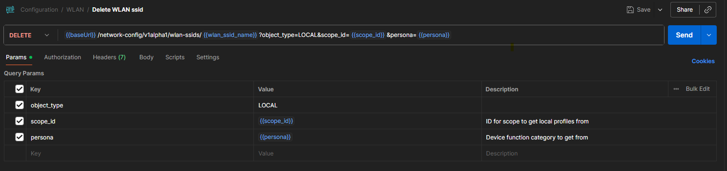

Deleting a local profile with Central API is simple now that we already know how to create a local profile. Follow the same instructions for assigning with Central API to craft a request with the required parameters to get started. The only differences are instead of using a post request use a delete request, and no additional body is required.
Deleting is just like with the Central UI, you must use the scope ID where the local profile was originally created. For example if you try to delete an inherited profile at the device level that was created as a local profile at the site level you will get a 400 bad request error.
