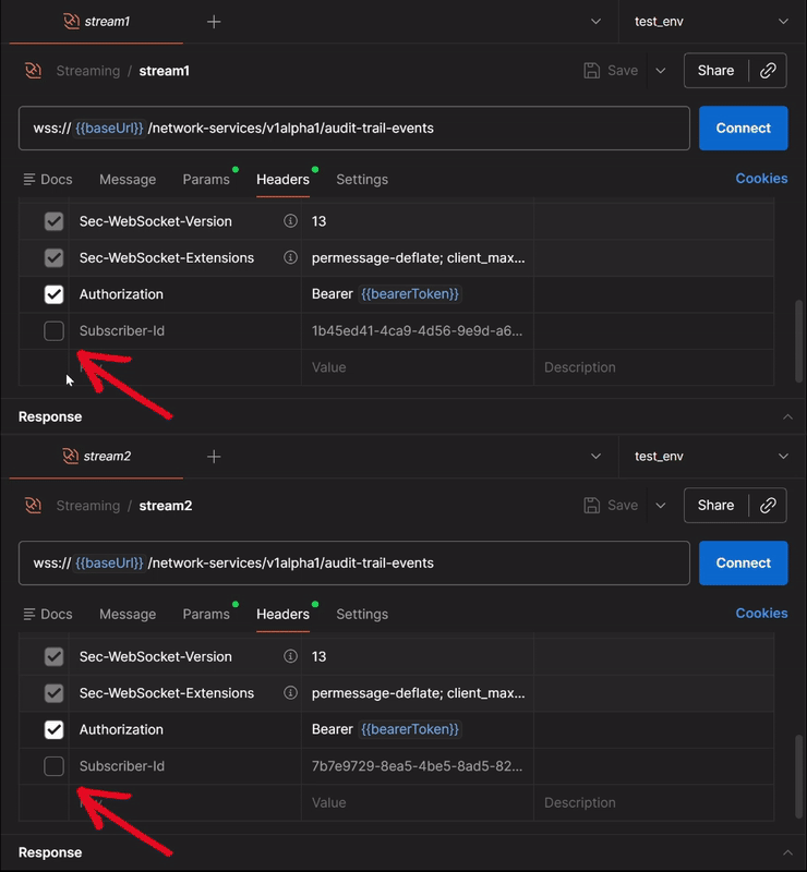

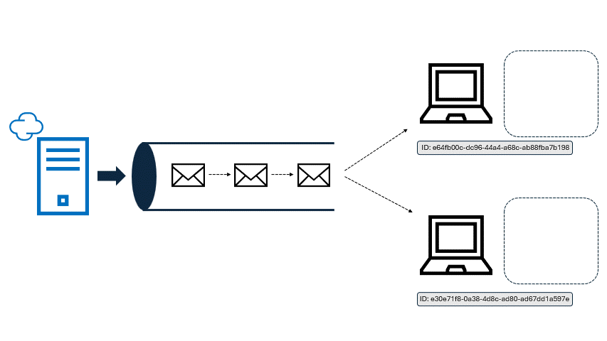

Mirror Mode
In Mirror Mode, each connection receives all events independently. To enable Mirror Mode clients must add a Subscriber-Id header to their request when connecting with a unique ID value. Each unique Subscriber ID receives all events from the Streaming API. This mode is useful when multiple independent clients need complete event streams.
Example: In the animation below two clients are each connected with a unique subscriber ID. All events are sent to both clients independently.
Mirror Mode
Mirror Mode Postman Example
