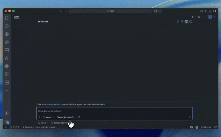

Approve Tool Calls
On the first time a Central MCP tool is used, VS Code will prompt you to approve it. Click Allow to proceed. You can also set tools to always allow from the same dialog.
[GIF: VS Code tool approval dialog appearing when a Central MCP tool is called, showing Allow / Allow Always / Deny buttons, user clicking Allow Always]

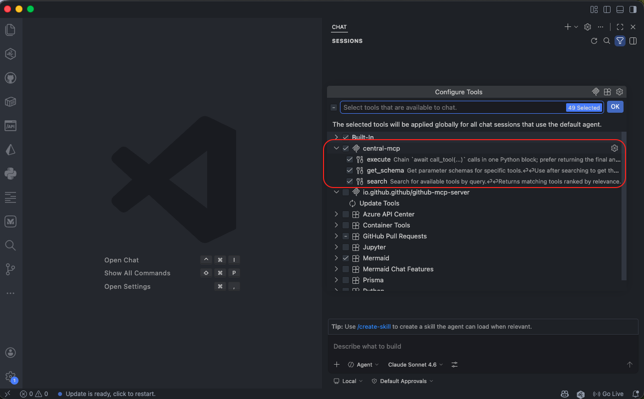

Verify the Connection
Open the Copilot Chat panel (View → GitHub Copilot → Open Chat). Switch to Agent mode using the mode selector at the top of the panel.
Click the tools icon to expand the tool list. What you see depends on whether Code Mode is enabled:
- Default (no
DYNAMIC_TOOLS): All 14 tools are listed individually —central_get_sites,central_get_devices,central_get_ap_wlans,central_get_clients, and so on. - Code Mode (
DYNAMIC_TOOLS=true): Three meta-tools are listed:Search,GetSchemas, andExecute.
Either confirms the server is connected and ready.
