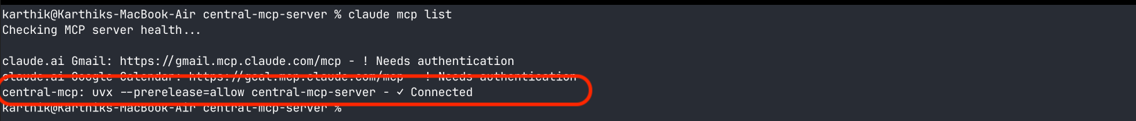

-- uvx --prerelease=allow central-mcp-serverVerify the Registration
claude mcp listThe output should include central-mcp with a Connected status if the server is correctly configured & connected to Central.
If Code Mode is disabled, Claude Code will have access to all 14 central_* tools directly. If Code Mode is enabled, Claude Code will instead use Search, GetSchemas, and Execute to work with the same Central data.

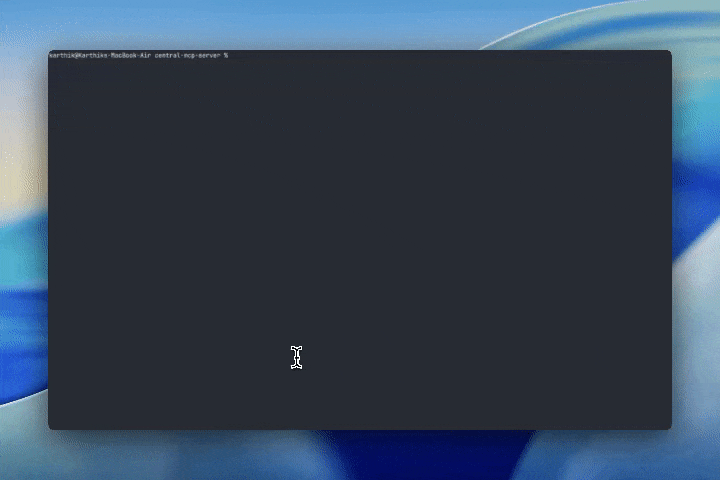

Run Your First Query
One-shot query:
claude -p "Which sites have poor health scores right now?"
Or start an interactive session:
A successful response retrieves live site data from your Central instance. You'll see tool call activity in the terminal as the AI searches available tools to find and call the appropriate Central APIs & provide a response.
