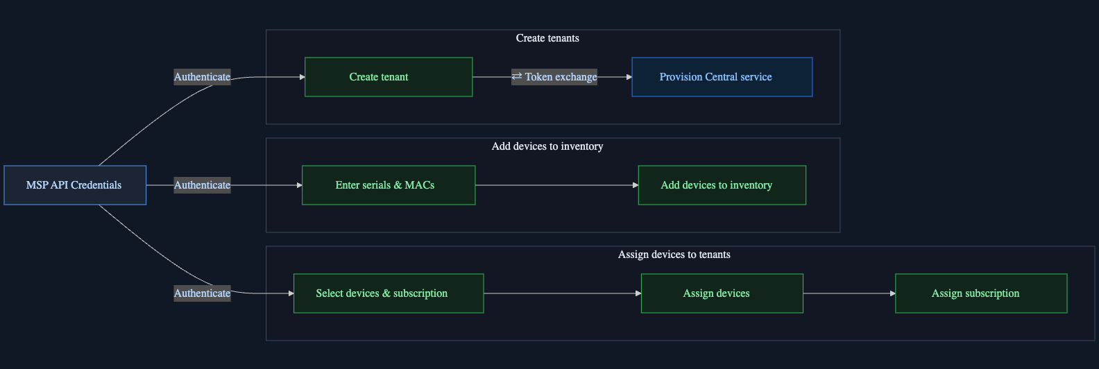

Automate the three most common MSP onboarding workflows using MSP API Credentials:
- Create tenants: Create new MSP tenants and provision a Central service in each.
- Assign devices to tenants: Assign MSP-owned devices in an existing tenant's Central application and attach the subscription each device needs.
- Add devices to inventory: Add new devices (serial number and MAC address) to the MSP workspace inventory.
Devices and tenants details can be entered individually or uploaded in bulk via CSVs. It ships in two forms: a guided web workflow and a Python CLI (onboarding.py) for scripted, manifest-driven runs.

The flow has three stages: discover tenants and services at the MSP level, exchange into a tenant to provision a service, then assign devices and seats from the MSP workspace. It maps directly onto the pycentral MSPBase feature:

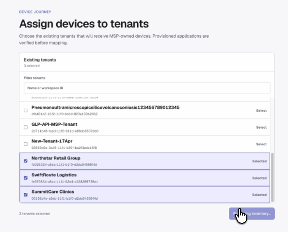

1. Select Tenants
Select one or more tenants that you want to include in the assignment.
The tool discovers the applicable service and region for each tenant and identifies any tenants that are not eligible for assignment.

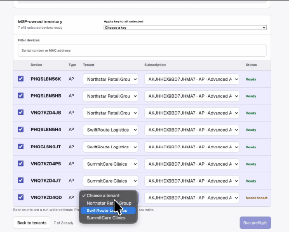

2. Select Devices and Subscriptions
Select the devices to assign and map each device to its destination tenant and subscription.
The UI displays the available device inventory and subscription information, including capacity and expiration details, to help build the assignment plan.

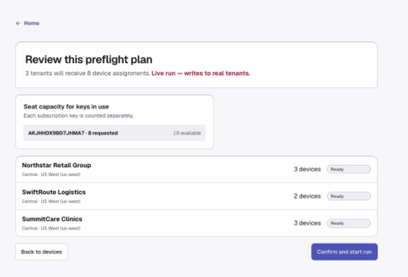

3. Pre-flight Review
Before making any changes, the tool validates the complete assignment plan.
Any validation issues are surfaced before the operation begins so that they can be corrected without making changes.

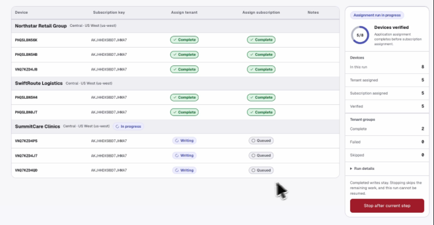

4. Live Run
After the pre-flight review passes, start the assignment.
The UI transitions from the review into a live execution view, showing progress and status for each device as the assignments are processed.
Results are displayed per device, including completed, already satisfied, and failed operations.
