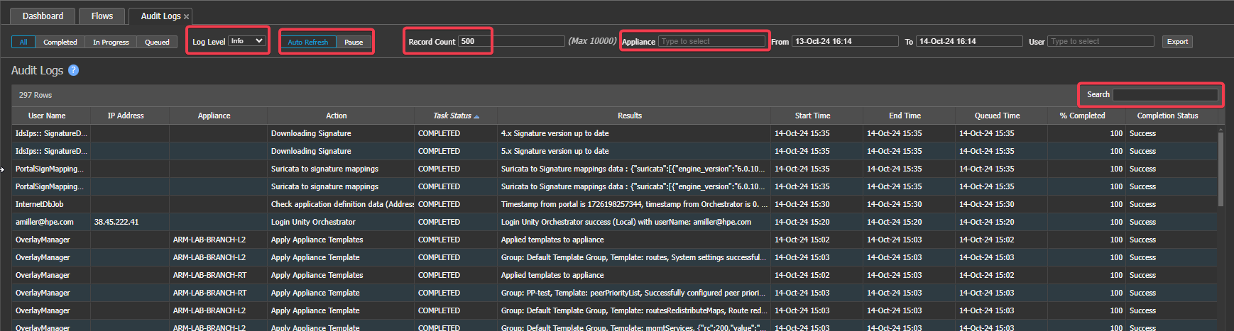

Audit Logs are everything the Orchestrator is doing. From configuring tunnels to pushing templates/overlays and IDP/IPS signature updates.
It also tracks changes to configs.
Audit log are useful to "watch" a new site and see the progress on the templates and tunnels configs.
You will note that Orch will "rest" sometimes for 3-4 minutes between steps.
The below red boxes at the most common things to change while looking at a device.
Note that filtering a device will not show you both sides, however using the "search" at the top right of the table, for the EC name, will show tunnels getting pushed to other EC for that devices as well. Orch tends to push all remote tunnels at once (EG to the hubs or remote MESH EC's) and push all local EC configs after. Sometimes Local then remote - the order on this seems to be random. The lesson here is be patient and wait for Orch to complete. Then troubleshoot if needed. Some tunnels can take a bit to come up especially those with PAT/CGNAT.
