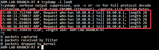

Best Practice: Use to quickly verify packets, will need to filter with larger networks. For heavy traffic (high pps) that can be hard to filter, use packet capture and pcap software. This is for quick check/answer type troubleshooting.

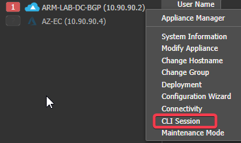

Best Practice: Run TCPdump from Orch CLI session
Right click or click the 3 line menu of the EC orch tree and select CLI session

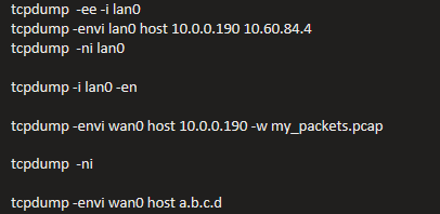

TCPdump has many options for example:
You may need/want other options like these examples:
