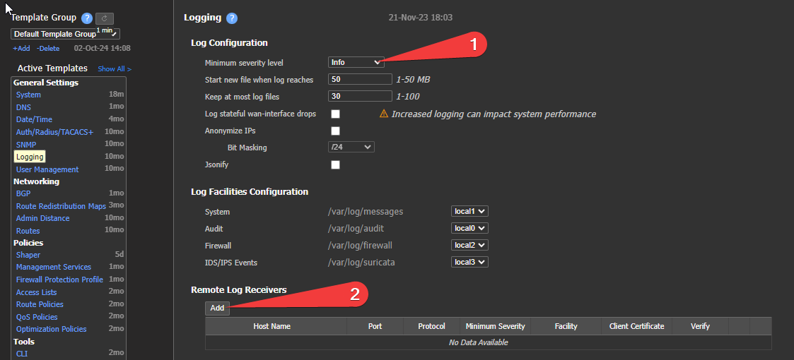

Add logging option and collector here
  1. Notice is usually fine "Info" can provide more details.
    1. Debug only turn on if request by tac and only for select devices.
  2. Click to setup your remote Log collectors.

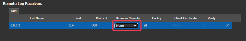

Logging Template
Logging Template
If "Minimum Severity is set to "none" no logs are sent
Change severity to receive logs

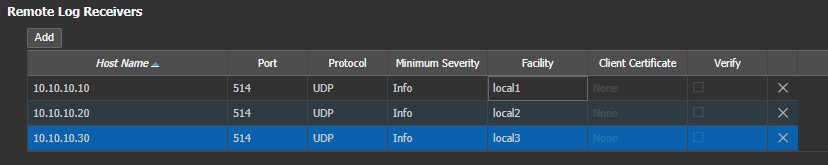

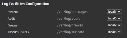

Facilities
Facilities allows different category logs to go to different log receivers
Example: (sending System, Firewall, and IDS/IPS logs to different destinations.)
Sending logs to different log receivers
