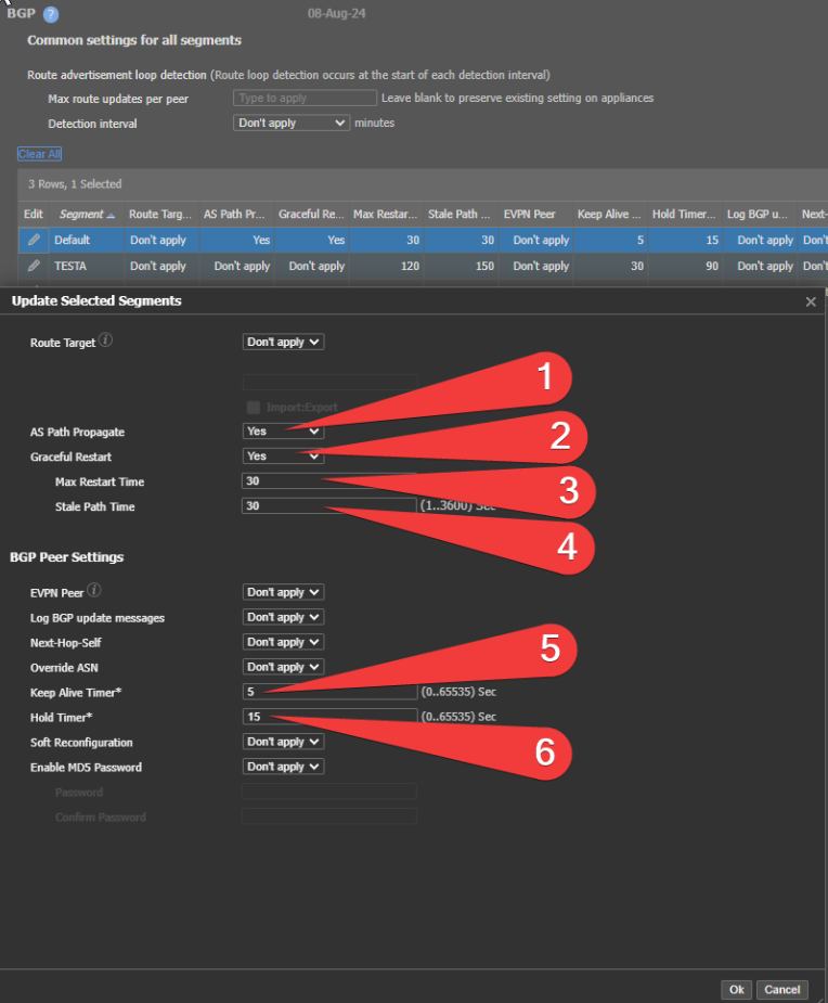

Best Practice: Set a template - remember to unclude all segments
This set the baseline BGP settings - so you don't have to remember everytime you add a BGP neighbor Keeps setting consistent.
Routing options:
(1)AS Path Propagate > Yes
(2)Graceful Restart > Yes
(3)Max > 30
(4)Stale > 60
Above not mandatory may adjust higher/lower, these are reference values
Keep Alive Timer
(5)Set 5
Adjust higher/lower to match your environment
Hold timer
(6)Set 15
We do not use the AS-PATH for fabric routing (inter-fabric does not run BGP) however we do pass the AS-PATH over/through the fabric so BGP routing points can use this information.
