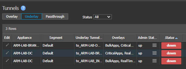

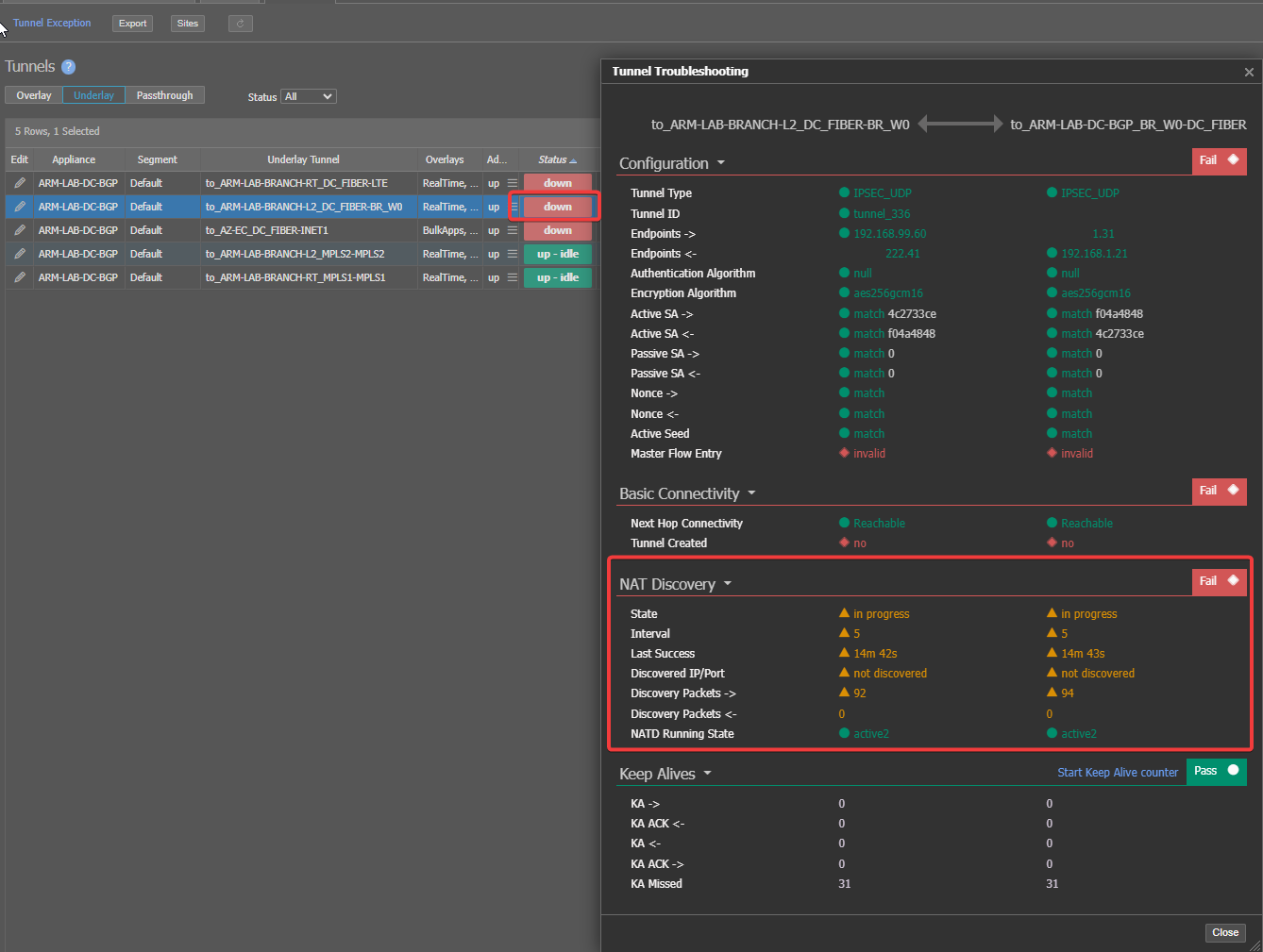

Click the “DOWN” for information – in this case NAT discovery is failing.
• My LAB SRX firewall Is dropping the tunnel traffic because ports do not match up (discovery is failing)
- Let’s investigate- notice one side has two private IP addresses above.
- This points to NAT issue.

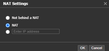

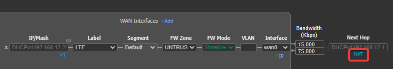

- Right Click on appliance from left tree > deployment
- LAB-DC is set for NAT.
- This is Correct – Behind Starlink NAT/CGNAT

Out: 98.97.12.231/12000 --> x.x.222.41/1454;udp,<<<< NOTE: incorrect portBRANCH-RT - is set for “NOT BEHIND NAT”
This is wrong – Connection is non static LTE has a private IP address via DHCP to EC WAN interface.
Let’s change this and see what happens
Tunnels remain Down.

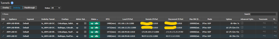

Got-yah! – sometimes CG-NAT tunnels will come up on pure luck, however they usually do not stay up and will drop randomly!

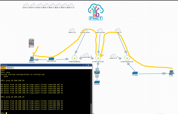

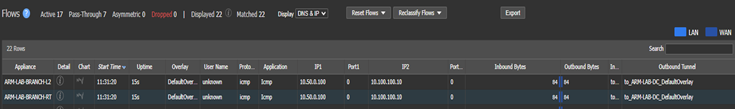

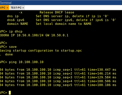

Now you have tunnels. If you have the LAN side plugged in and routing, and devices on each side, you should be able to pass traffic.
Able to ping from branch to branch.

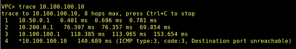

This ping is flowing path: Branch-RT (LTE WAN) > HUB (Fiber-in) (hairpin) > Hub (Fiber-out) > Branch-L2 (Starlink) | See trace below.
The Echo is the same path in reverse. Hub and spoke – hairpins in hub.
